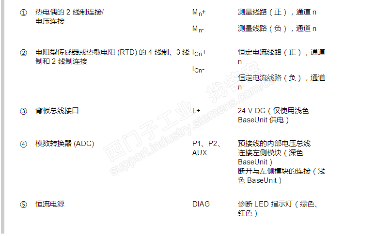

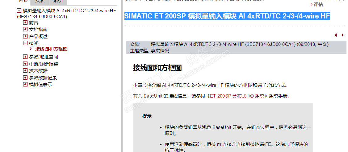

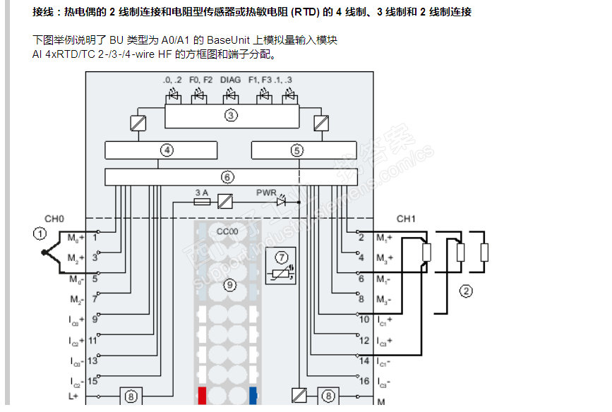

SIMATIC ET 200SP 模拟量输入模块 AI 4xRTD/TC 2-/3-/4-wire HF
https://support.industry.siemens.com/cs/mdm/59753600?c=116496730635&lc=zh-CN
接线如附图!
