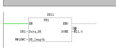

FB1的程序如下:
OPN #Data_DB
M002: LAR1 P#DBX 0.0
SET
S #Sort_done
R #DONE
L #DB_length
L 1
-I
Loop: T #Count
L W [AR1,P#0.0]
L W [AR1,P#2.0]
<=I
JC M003
// change M(INDEX+1) for M(INDEX)
L W [AR1,P#0.0]
T #Temp
L W [AR1,P#2.0]
T W [AR1,P#0.0]
L #Temp
T W [AR1,P#2.0]
SET
R #Sort_done
M003: TAR1
L 16
+D
LAR1
L #Count
LOOP Loop
AN #Sort_done
S #DONE
JC M002
BE
刚开始,仿真运行不了,CPU处于stop状态,后来下载了OB 80,81.....OB122等组织块,监视FB1时,提示“function not permitted in current mode”,运行不了,后来将所有的块重新下载,可以运行了。但是FB1始终执行不了。如下图.请高手指导下,谢谢
