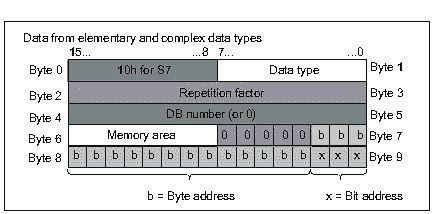

这样的数据格式是怎么转换的呢?为什么是这样做的呢?
like821080
    728
注册时间:2008-09-05
957
2012-12-04 16:14:32
L W#16#1002 //S7 word //S7 WORD是什么呢?1002代表什么呢?
T LW 0 //->Src.type
T LW 10 //->Dest.type
L #NoOfByte
T LW 2 //->Src.factor
T LW 12 //->Dest.factorr
L #DBSource
T LW 4 //->Src.DB
L #DBDest
T LW 14 //->Dest.DB
L #ByteSource
SLD 3 //为什么要使用SLD 3 然后跟 DW#16#84000000或下
L DW#16#84000000
OD
T LD 6 //->Src.BitAddress
L #ByteDest
SLD 3 //->Dest.BitAddress
L DW#16#84000000
OD
T LD 16
CALL "S7_BLKMOV"
SRCBLK :=#Src
RET_VAL:=#error
DSTBLK :=#Dest
L #error
L 0
<>I
= #Fault
望高手能指点!
