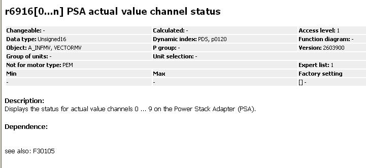

手册上r6916的解释为:
r6916[0...n] PSA actual value channel status
Changeable: - Calculated: - Access level: 1
Data type: Unsigned16 Dynamic index: PDS, p0120
Object: A_INFMV, VECTORMV P group: - Version: 2603900
Group of units: -
Not for motor type: PEM Expert list: 1
Des cription:
Displays the status for actual value channels 0 ... 9 on the Power Stack Adapter (PSA).
发生故障后的r6916的值为0002H
奇怪的是,这个故障发生没有规律,有时候合闸了马上跳闸,有时候变频器运行一会儿了才跳开。
