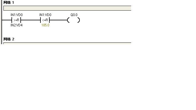

LDR>= IN1:VD0, IN2:VD4
AR<= IN1:VD0, 185.0
= Q0.0
