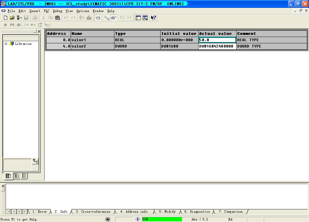

将同一个浮点数(50.0)经过REAL_TO_DWORD转换后分别写入DB1.DBD0(REAL)和DB1.DBD4(DWORD),结果是:
DB1.DBD0中是浮点数的REAL值,而DB1.DBD4中是浮点数的十六进制值(IEEE):
