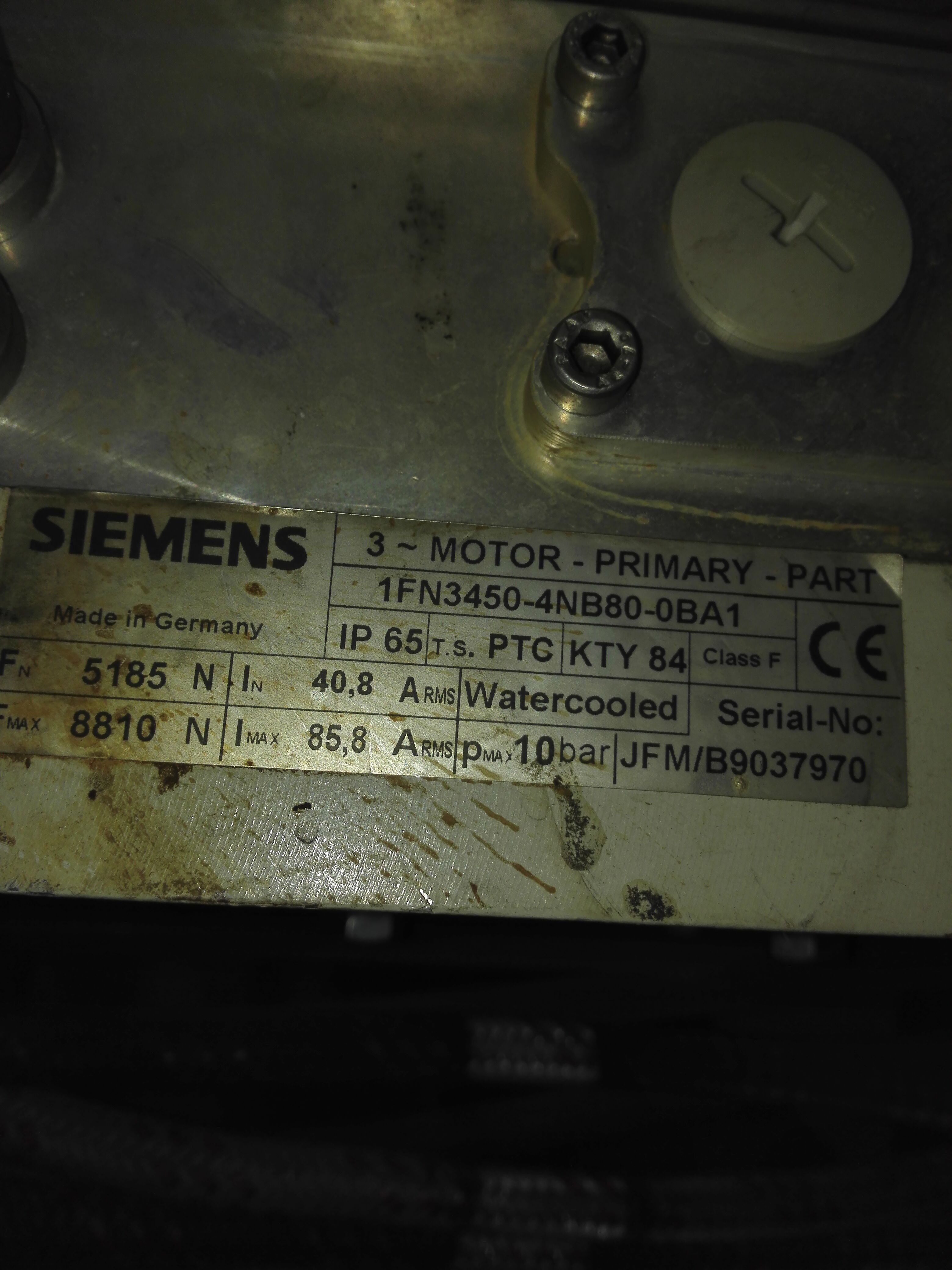

P0640=85
P1530=9.16
P1531=-9.16
P1522=5185
P1523=-5185
