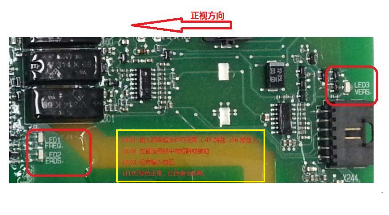

回复:BLM的TCB板上的三个指示灯分别是什么意思?
西门子驱动技术支持
    73
    9
    21
注册时间:2007-09-03
发布于 2015-10-10 11:56:07
6楼
TCB module has 3 duo-color LED, by red means fault, green means OK.
    - LED1    impermissible power frequency
    - LED2    short-circuit to ground
    - LED3    TCB power supply
