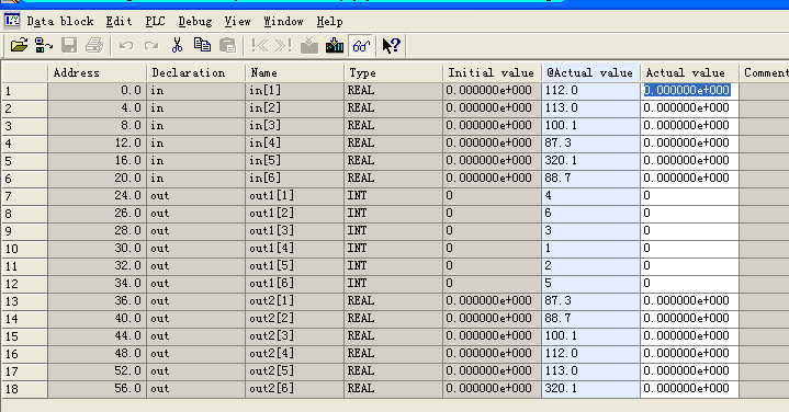

我也试着做了下,就是想请教各位SCL点击监控变量后,怎样操作再回到编辑状态呀?
FUNCTION_BLOCK FB2
VAR_INPUT  //输入变量
  in: ARRAY[1..6]OF REAL;
END_VAR
VAR_OUTPUT  //输出变量
out1: ARRAY[1..6]OF INT;
out2: ARRAY[1..6]OF REAL;
END_VAR
VAR_TEMP //临时变量
   temp1: INT;
    temp2: INT;
    temp3: REAL;
    temp5: INT;
 END_VAR
   FOR temp1:= 1 TO 6 BY 1 DO  //可以把temp1,6定义为输入变量,这样就可以扩展了
    out1[temp1] :=temp1;
    out2[temp1] :=in[temp1];
  END_FOR;
 FOR temp1:= 1 TO 5 BY 1 DO
       FOR temp2:= temp1+1 TO 6 BY 1 DO
           IF out2[temp1]>out2[temp2]   THEN
           temp3:= out2[temp1];
           out2[temp1]:=out2[temp2];
           out2[temp2]:=temp3;
           temp5 :=out1[temp1];
           out1[temp1]:= out1[temp2];
           out1[temp2]:=temp5 ;
           END_IF;
       END_FOR;
    END_FOR;
END_FUNCTION_BLOCK
