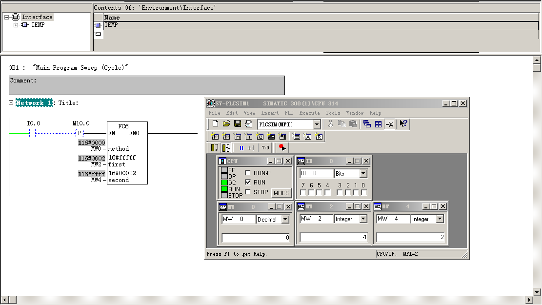

举一反三,两值互换。
FUNCTION FC 6 : VOID
TITLE =exchange two values
//exchange two values
VERSION : 0.1
VAR_INPUT
  method : WORD ;
END_VAR
VAR_IN_OUT
  first : WORD ;
  second : WORD ;
END_VAR
VAR_TEMP
  temp : WORD ;
END_VAR
BEGIN
NETWORK
TITLE =
//choose method
      L     #method;
      L     W#16#0;
      ==I   ;
      JC    m000;
      L     #method;
      L     W#16#1;
      ==I   ;
      JC    m001;
      L     #method;
      L     W#16#2;
      ==I   ;
      JC    m002;
//method one
m000: L     #first;
      L     #second;
      T     #first;
      TAK   ;
      T     #second;
      JU    m003;
//method two
m001: L     #first;
      T     #temp;
      L     #second;
      T     #first;
      L     #temp;
      T     #second;
      JU    m003;
//method 3
m002: L     #first; //a=a^b
      L     #second;
      XOW   ;
      T     #first;
      L     #first; //b=b^a
      L     #second;
      XOW   ;
      T     #second;
      L     #first; //a=a^b
      L     #second;
      XOW   ;
      T     #first;
//quit
m003: SET   ;
      SAVE  ;
    BE;
END_FUNCTION
