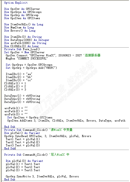

分别在VB和WinCC内部变量中定义了3个变量,16位Word型。
编程时,VB中的 Text1、2、3分别对应于wincc中的aa、bb、cc,
但是,当按下“写按钮”时,却是将 Text1正确写入了bb,其他没变化。
当按下“读按钮”时,却是Text2、3正确读入了aa、bb。Text1变成了空白,如附图所示。
是哪儿错了?
Option Explicit
Dim OpcSvr As OPCServer
Dim OpcGrps As OPCGroups
Dim OpcGrp As OPCGroup
Dim OpcItms As OPCItems
Dim ItemSvrHdls() As Long
Dim NumItem As Long
Dim Errors() As Long
Dim ItemIDs(3) As String
Dim DataType(1000) As Integer
Dim accPath(1000) As String
Dim CltHdls(3) As Long
Private Sub Form_Load()
Set OpcSvr = New OPCServer
 OpcSvr.Connect "OPCServer.WinCC", 20160623 - 2027 '连接服务器
 MsgBox "CONNECT SUCCESSFUL"
 Set OpcGrps = OpcSvr.OPCGroups
 Set OpcGrp = OpcGrps.Add("VBOPC")
ItemIDs(1) = "aa"
ItemIDs(2) = "bb"
ItemIDs(3) = "cc"
CltHdls(1) = 1
CltHdls(2) = 2
CltHdls(3) = 3
DataType(1) = vbVString
DataType(2) = vbVString
DataType(3) = vbVString
accPath(1) = ""
accPath(2) = ""
accPath(3) = ""
  Set OpcItms = OpcGrp.OPCItems
  OpcItms.AddItems 3, ItemIDs, CltHdls, ItemSvrHdls, Errors, DataType, accPath
End Sub
Private Sub Command3_Click() '读WinCC 中变量
Dim plcVal() As Variant
OpcGrp.SyncRead OPCCache, 3, ItemSvrHdls, plcVal, Errors
 Text1.Text = plcVal(1)
 Text2.Text = plcVal(2)
 Text3.Text = plcVal(3)
End Sub
Private Sub Command4_Click() '写入WinCC 中
 Dim plcVal(3) As Variant
 plcVal(1) = Text1.Text
 plcVal(2) = Text2.Text
 plcVal(3) = Text3.Text
  OpcGrp.SyncWrite 3, ItemSvrHdls, plcVal, Errors
End Sub
