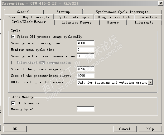

最近因为外部故障CPU停止运行:
S7-400 PLC,416-2DP;
通过PN口连接PNPN coupler。
Event 29 of 120:  Event ID 16# 494D
STOP due to IO error
No relevance for user (Z1): 9182
No relevance for user (Z2): 03b0 (Z3): 04f9
Previous operating mode: RUN
Requested operating mode: STOP (internal)
External error, Incoming event
11:00:25.652 AM  07/18/2016
(Coding: 16# 494D  FF84  5050  9182  03B0  04F9)
Event 30 of 120:  Event ID 16# 38B3
I/O access error when updating the process image input table outgoing
Access error occurred with user data
Process image partition no.:  0
Start address of I/O area involved:   1000, Length of the area: 196
Requested OB: Program execution error OB (OB85)
Priority class: 25
External error, Outgoing event
程序里面已经调用了OB85.配置如下:
不知道大家有没有遇到相似的问题?对于IO故障的配置这样配置是否正确。
希望大家能帮忙提供一些信息,帮助分析解决该问题。
非常感谢。
