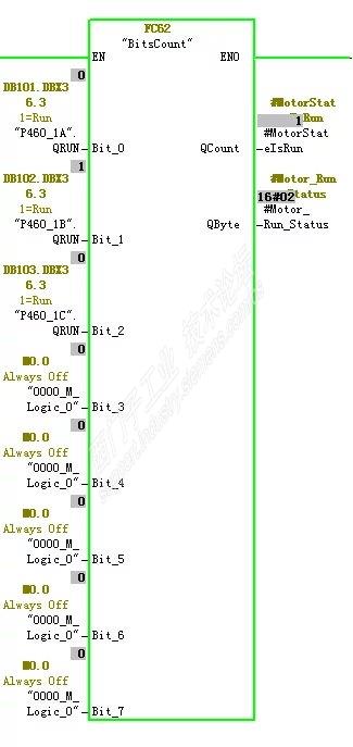

回复:用STL如何来确定一个字节中有几个位为1

BitsCount源代码:
      L     P##Qby  //Temp,byte
      LAR1
      A     #Bit_0
      =      [AR1,P#0.0]
      A     #Bit_1
      =      [AR1,P#0.1]
      A     #Bit_2
      =      [AR1,P#0.2]
      A     #Bit_3
      =      [AR1,P#0.3]
      A     #Bit_4
      =      [AR1,P#0.4]
      A     #Bit_5
      =      [AR1,P#0.5]
      A     #Bit_6
      =      [AR1,P#0.6]
      A     #Bit_7
      =      [AR1,P#0.7]
      L     #Qby
      T     #QByte
      L     0
      T     #QCount
      LAR1  P##Qby
      L     8
NEXT: T     #Index //Temp,int
      A      [AR1,P#0.0]
      JCN   a0b0
      L     1
      L     #QCount
      +I
      T     #QCount
a0b0: CLR
      +AR1  P#0.1
      L     #Index
      LOOP  NEXT
