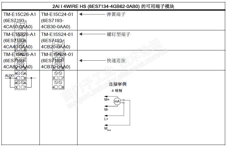

6ES7134-4GB62-0AB0 2AI I 4WIRE HS 能否接二线制传感器?
