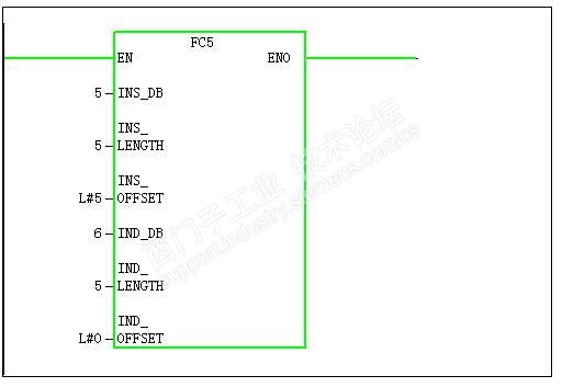

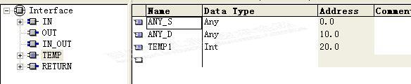

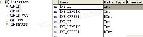

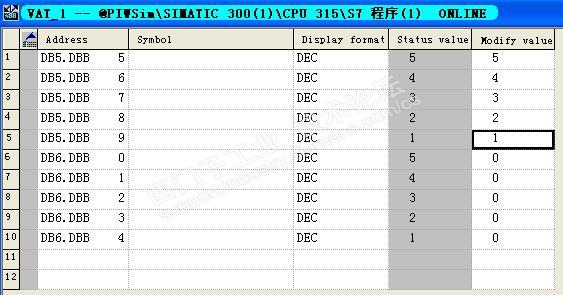

写了一段程序,进行模拟了,共大家参考下:
  L     B#16#10
      T     LB     0
      L     B#16#2
      T     LB     1
      L     #INS_LENGTH
      T     LW     2
      L     #INS_DB
      T     LW     4
      L     P#DBX 0.0
      L     #INS_OFFSET
      SLD   3
      +D
      T     LD     6
      L     B#16#10
      T     LB    10
      L     B#16#2
      T     LB    11
      L     #IND_LENGTH
      T     LW    12
      L     #IND_DB
      T     LW    14
      L     P#DBX 0.0
      L     #IND_OFFSET
      SLD   3
      +D
      T     LD    16
      CALL  "BLKMOV"
       SRCBLK :=#ANY_S
       RET_VAL:=#TEMP1
       DSTBLK :=#ANY_D
复制DB5.DBB5开始的5个字节到DB6.DBB0开始的5个字节里
