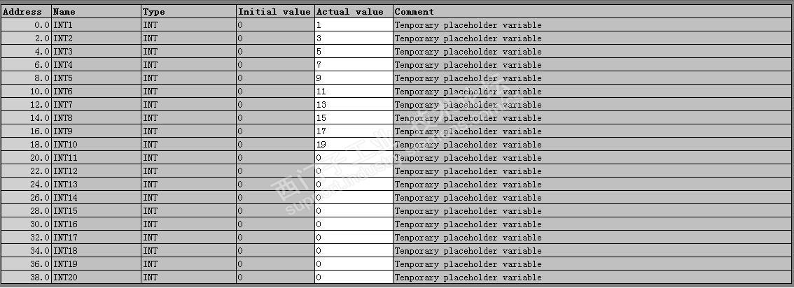

OB1程序:
 L     P##Total
      LAR1
      L     B#16#10
      T     B [AR1,P#0.0]
      L     B#16#5
      T     B [AR1,P#1.0]
      L     20
      T     W [AR1,P#2.0]
      L     B#16#1
      T     W [AR1,P#4.0]
      L     B#16#0
      T     D [AR1,P#6.0]
      L     P##Odd
      LAR1
      L     B#16#10
      T     B [AR1,P#0.0]
      L     B#16#5
      T     B [AR1,P#1.0]
      L     20
      T     W [AR1,P#2.0]
      L     B#16#2
      T     W [AR1,P#4.0]
      L     B#16#0
      T     D [AR1,P#6.0]
      L     P##Even
      LAR1
      L     B#16#10
      T     B [AR1,P#0.0]
      L     B#16#5
      T     B [AR1,P#1.0]
      L     20
      T     W [AR1,P#2.0]
      L     B#16#3
      T     W [AR1,P#4.0]
      L     B#16#0
      T     D [AR1,P#6.0]
      CALL  FC     1
       Total:=#Total
       Odd  :=#Odd
       Even :=#Even
定义3个Any指针
FC1:
 L     P##Total
      LAR1
      L     B [AR1,P#1.0]
      T     #Total_DB_Type
      L     W [AR1,P#2.0]
      T     #Total_DB_Quantity
      L     W [AR1,P#4.0]
      T     #Total_DB_Number
      L     D [AR1,P#6.0]
      T     #Total_DB_StartAddress
      L     P##Odd
      LAR1
      L     B [AR1,P#1.0]
      T     #Odd_DB_Type
      L     W [AR1,P#2.0]
      T     #Odd_DB_Quantity
      L     W [AR1,P#4.0]
      T     #Odd_DB_Number
      L     D [AR1,P#6.0]
      T     #Odd_DB_StartAddress
      L     P##Even
      LAR1
      L     B [AR1,P#1.0]
      T     #Even_DB_Type
      L     W [AR1,P#2.0]
      T     #Even_DB_Quantity
      L     W [AR1,P#4.0]
      T     #Even_DB_Number
      L     D [AR1,P#6.0]
      T     #Even_DB_StartAddress
解析3个Any指针
      L     #Total_DB_StartAddress
      LAR1
      L     #Odd_DB_StartAddress
      LAR2
      L     #Total_DB_Quantity
Nex1: T     #CycleCount
      OPN   DB [#Total_DB_Number]
      L     DBW [AR1,P#0.0]
      L     2
      /I
      T     LD    30
      A(
      L     #Remainder
      L     0
      ==I
      JC    M001
      L     DBW [AR1,P#0.0]
      OPN   DB [#Odd_DB_Number]
      T     DBW [AR2,P#0.0]
      +AR2  P#2.0
M001: NOP   0
      +AR1  P#2.0
      L     #CycleCount
      LOOP  Nex1
//提取奇数
      LAR1
      L     #Even_DB_StartAddress
      LAR2
Nex2: T     #CycleCount
      L     DBW [AR1,P#0.0]
      L     2
      /I
      T     LD    30
      A(
      L     #Remainder
      L     0
      ==I
      JCN   M002
      L     DBW [AR1,P#0.0]
      OPN   DB [#Even_DB_Number]
      T     DBW [AR2,P#0.0]
      +AR2  P#2.0
M002: NOP   0
      +AR1  P#2.0
      L     #CycleCount
      LOOP  Nex2
//提取偶数
测试:
      L     1
      T     MW     0
      L     0
      T     MD    10
      OPN   DB     1
      L     20
Next: T     MD    20
      L     MW     0
      T     DBW [MD 10]
      L     MW     0
      L     1
      +I
      T     MW     0
      L     MD    10
      L     2
      SLW   3
      +I
      T     MD    10
      L     MD    20
      LOOP  Next
在DB1中填写1-20 20个整数
DB2中是提取的奇数
DB3中是提取的偶数
