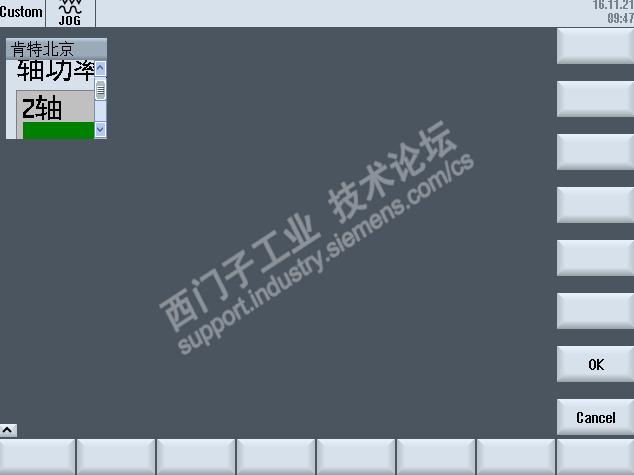

//s(start)
HS5=("project",ac7,se1)
press(hs5)
lm("mpw")
end_press
//end
//M{mpw,hd="肯特北京",X=10,Y=10,W=100,H=100}
