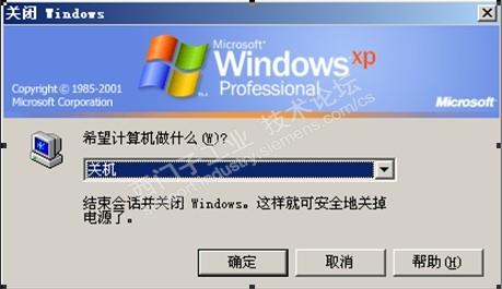

1. 简单举例
在API.XLS的Sheet1中加入如下代码:
Private Declare Function SHShutDownDialog Lib "shell32" Alias "#60" (ByValYourGuess As Long) As Long
Public Sub ShowShutDownDlg() '显示关机界面
   SHShutDownDialog 0
End Sub
在WinCC调用之前先用EXCEL运行一下,效果如下:
接下来由WinCC的VBS调用如下:
Dim oExcelFile,oExcel,oWorkBook,oSheet
oExcelFile= HMIRuntime.ActiveProject.Path + "APIXLSAPI.XLS"
Set oExcel = CreateObject("Excel.Application")
Set oWorkBook = oExcel.workbooks.OPen(oExcelFile)
Set oSheet = oWorkBook.Sheets("Sheet1")
oExcel.run "Sheet1.ShowShutDownDlg"
oWorkBook.Close
Set oWorkBook = Nothing
oExcel.quit
Set oExcel = nothing
效果和EXCEL中是一模一样的,^_^。
