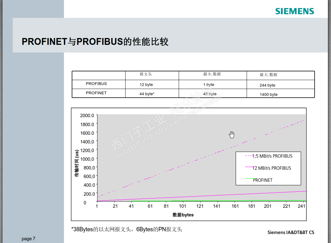

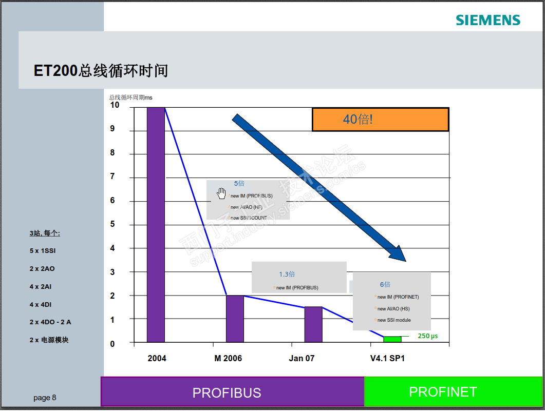

PROFINET与PROFIBUS的比较
https://support.industry.siemens.com/cs/cn/zh/view/109481431
