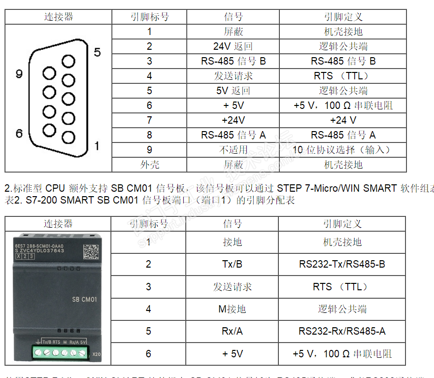

S7-200 SMART 通信端口以及连接方式
http://www.ad.siemens.com.cn/productportal/Prods/s7-200-smart-portal/200SmartTop/communication/Port/Connect.htm
