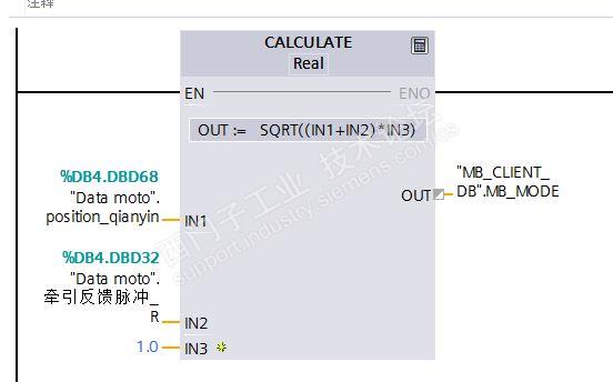

  回帖的几个,好奇怪,我怀疑都没用过就来评论了
这么多算法不够用?
+, -, *, /, Abs, Neg, Exp, **, Frac, Ln, Sin, ASin, Cos, ACos, Tan, ATan, Sqr, Sqrt, Round, Ceil, Floor, Trunc
