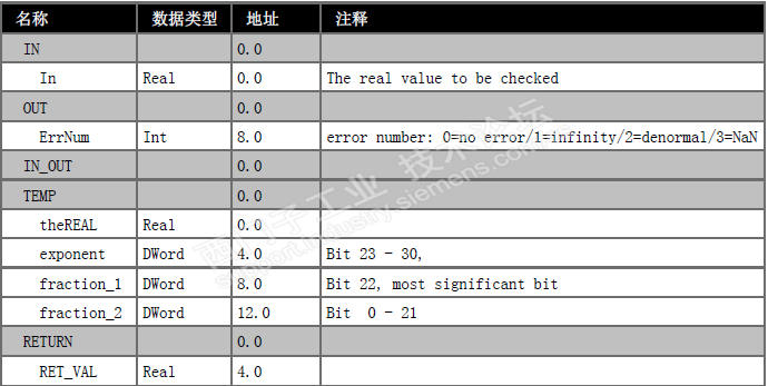

项目中遇到REAL计算输出成#NaN的情况,PCS7中用一个FC260来处理的,解密FC260得出的STL如下:

根据个人理解转成SCL如下:
FUNCTION "ChkREAL" :REAL
VAR_INPUT
    IN:REAL;
END_VAR
VAR_OUTPUT
    ErrNum:INT;
END_VAR
VAR_TEMP
    theREAL:REAL;
    exponent:DWORD;
    fraction_1:DWORD;
    fraction_2:DWORD;
END_VAR
ErrNum := 0;
theREAL := IN;
REALChk :=  theREAL;
exponent := REAL_TO_DWORD(theREAL) AND 16#7F800000;
fraction_1:= REAL_TO_DWORD(theREAL) AND 16#400000;
fraction_2:= REAL_TO_DWORD(theREAL) AND 16#3FFFFF;
IF exponent = 16#7F800000 THEN
    IF fraction_2 <> 16#0 & fraction_1 = 16#0 OR fraction_1 <> 16#0 THEN
        ErrNum := 3;
    ELSIF fraction_1 = 16#0  & fraction_2 = 16#0 THEN
        ErrNum := 1;
        IF theREAL > 0.0 THEN
            REALChk :=  3.402822e+038;
        ELSE
            REALChk :=  -3.402822e+038;
        END_IF;
    END_IF;
ELSE
    IF (fraction_2 <> 0 OR fraction_1 <> 0) & exponent = 0 THEN
        ErrNum := 2;
        REALChk :=   0.0;
    END_IF;
END_IF;
END_FUNCTION
求教大神转换是否准确,谢谢
