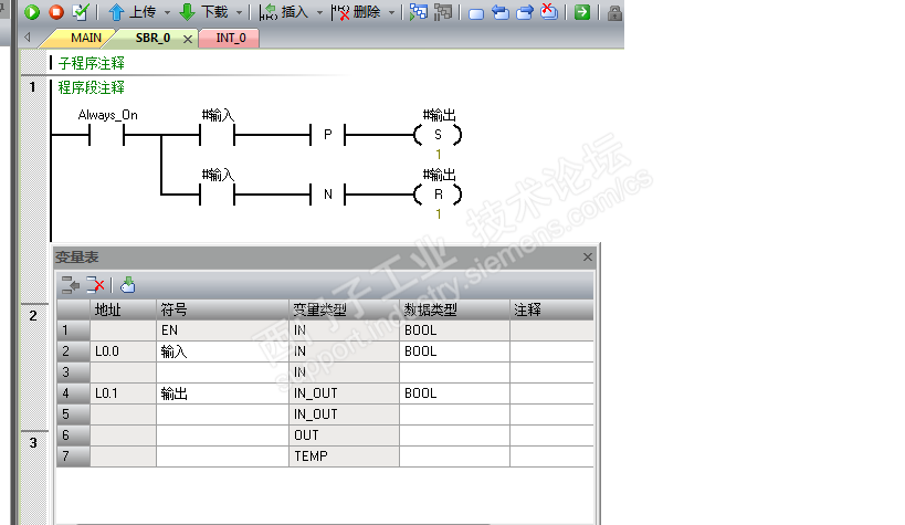

以下是引用xiaocong在2017-08-31 15:40:39的发言 >
 芳侠,如果我在主程序中同时多次调用上图的子程序,按你的例子该如何来做?
我把子程序调用了两次,就是这样的程序。
ORGANIZATION_BLOCK MAIN:OB1
TITLE=程序注释
VAR
边缘0:BOOL;
边缘1:BOOL;
边缘2:BOOL;
边缘3:BOOL;
END_VAR
BEGIN
Network 1
//  程序段注释
LD     SM0.0
=      L60.0
LD     I0.0
=      L63.7
LD     L60.0
CALL   SBR0, L63.7, L0.0, L0.1, Q0.0
Network 2
//  程序段注释
LD     SM0.0
=      L60.0
LD     I0.2
=      L63.7
LD     L60.0
CALL   SBR0, L63.7, L0.2, L0.3, Q0.1
END_ORGANIZATION_BLOCK
SUBROUTINE_BLOCK SBR_0:SBR0
TITLE=子程序注释
VAR_INPUT
输入:BOOL;
END_VAR
VAR_IN_OUT
记忆1:BOOL;
记忆2:BOOL;
输出:BOOL;
END_VAR
BEGIN
Network 1
//  程序段注释
LD     L0.0
LPS
AN     L0.1
S      L0.3, 1
LPP
=      L0.1
Network 2
LDN    L0.0
LPS
AN     L0.2
R      L0.3, 1
LPP
=      L0.2
END_SUBROUTINE_BLOCK
