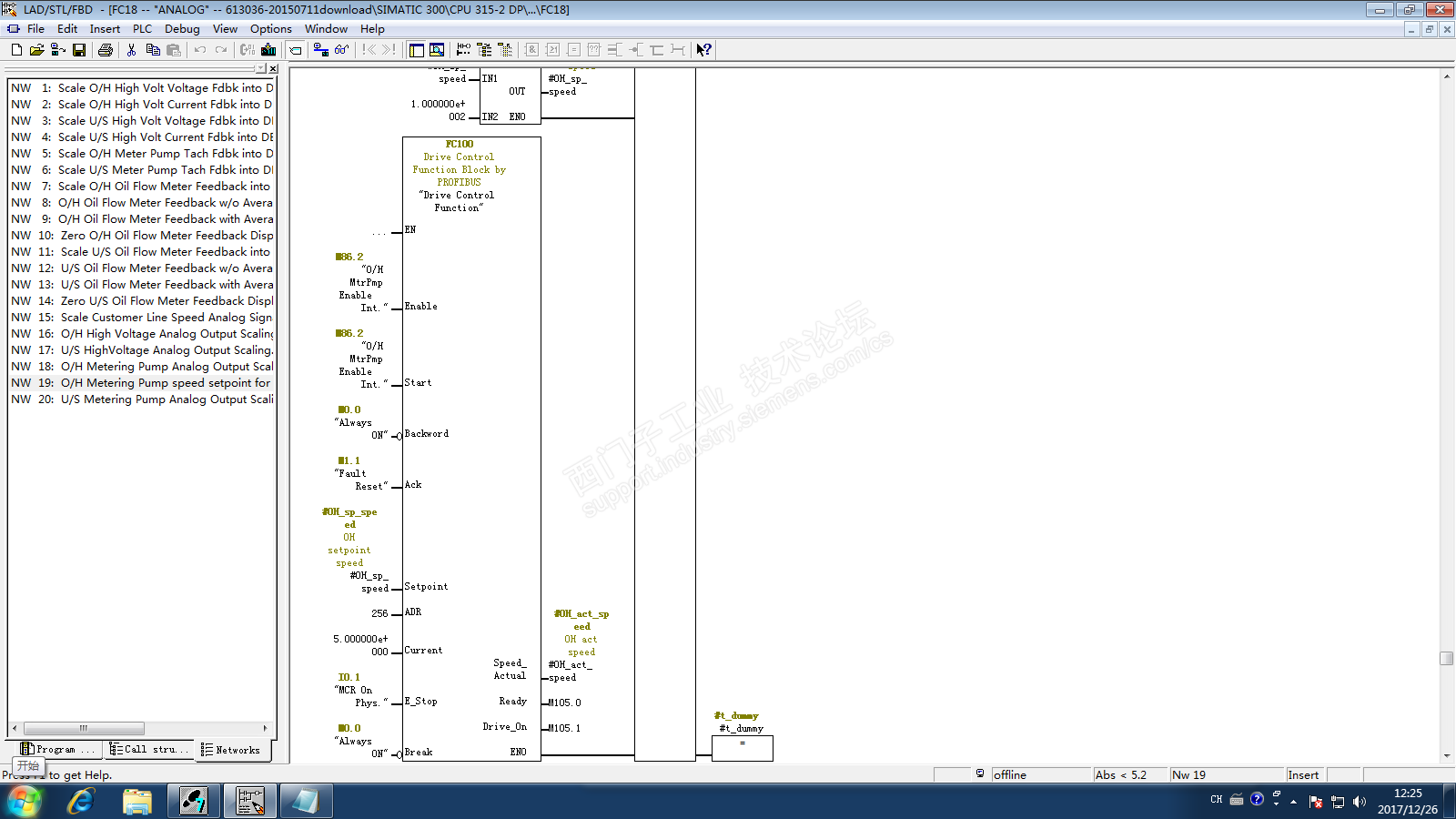

 G120的变频器控制块FC100如下:
现在想增加变频器的故障输出,应该怎么修改?
NETWORK1
 L     2#0
      T     LW     0
      A     #Enable                     // Bedingungen f黵 Einschalten des FU
      =     #Steu_Bit_01
      =     #Steu_Bit_03
      =     #Steu_Bit_04
      =     #Steu_Bit_05
      =     #Steu_Bit_06
      A     #Start                      // Antrieb START
      =     #Steu_Bit_00
      A     #E_Stop
      =     #Steu_Bit_02
      A     #Backword
      =     #Steu_Bit_11
      A     #Break
      =     #Steu_Bit_08
      A     #Ack
      =     #Steu_Bit_07
      L     LW     0
      L     2#10000000000               // pzd
      OW
      T     #Steuer
NETWORK2
     L     #Setpoint
      L     1.638400e+002
      *R
      RND
      T     #SW_DW
      L     16384
      L     LW    12
      >I
      JC    M1
      TAK
M1:   T     #Soll
      L     LD     2
      T     #Steu_Soll
      L     #ADR
      SLW   3
      LAR1
      L     #Steu_Soll
      T     PQD [AR1,P#0.0]
NETWORK3
   L     #ADR
      SLW   3
      LAR1
      L     PID [AR1,P#0.0]
      T     LD     6
      A     L      7.2
      =     #Drive_On
      AN    L      7.3
      =     #Ready
      L     #n_Ist_temp
      ITD
      DTR
      L     1.638400e+002
      /R
      T     #Speed_Actual
      SET
      SAVE
