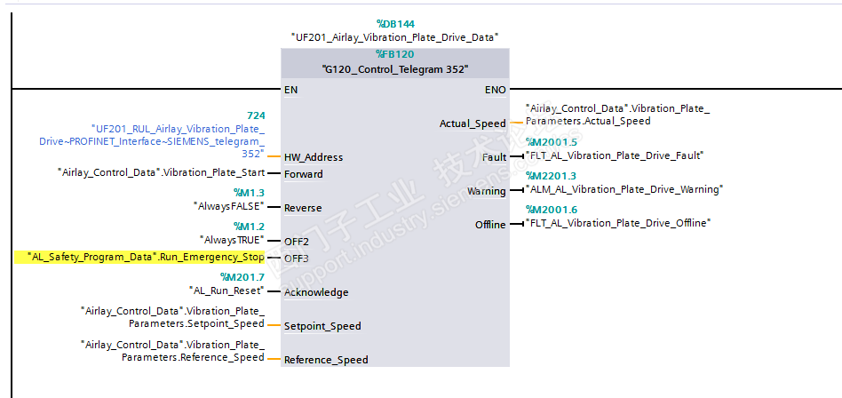

我也来贴一个1200和1500通用的G120变频器控制功能块吧
首先,功能块长这样
下面是功能块源代码
FUNCTION_BLOCK "G120_Control_Telegram 352"
{ S7_Optimized_Access := 'TRUE' }

(* 读取过程映像 *)
#GETIO_Instance(ID := #HW_Address,
                INPUTS := #Recevie);
(* 初始化 *)
#Send.Master_Control_PLC := TRUE;
#Send.Enable := TRUE;
#Send.Ramp_Fuction_Enable := TRUE;
#Send.Continue_Ramp := TRUE;
#Send.Setponit_Enable := TRUE;
(* 启动停止 *)
#Send.OFF1 := ((#Forward AND NOT #Reverse) OR (#Reverse OR #Forward)) AND #Recevie.Ready AND NOT #Recevie.Fault AND NOT #Diagnostic_Status.Communicate_Fault;
(* 方向选择 *)
#Send.Direction := #Reverse AND NOT #Forward;
(* 缓慢停止 *)
#Send.OFF2 := #OFF2;
(* 快速停止 *)
#Send.OFF3 := #OFF3;
(* 驱动器故障 *)
IF #Recevie.Fault AND #Recevie.Fault_Code <> 16#0 THEN
    #Record.Fault_Code := #Recevie.Fault_Code;
END_IF;
#Fault := #Recevie.Fault;
(* 驱动器警告 *)
IF #Recevie.Warning AND #Recevie.Warning_Code <> 16#0 THEN
    #Record.Warning_Code := #Recevie.Warning_Code;
END_IF;
#Warning := #Recevie.Warning AND #Record.Warning_Enable;
(* 故障确认 *)
#Send.Acknowledge := #Acknowledge;
(* 实际速度 *)
#Actual_Speed := INT_TO_REAL(#Recevie.Actual_Speed) * #Reference_Speed / 16384.0;
(* 实际电流 *)
#Current_Parameters.Actual_Current := INT_TO_REAL(#Recevie.Actual_Current) * #Current_Parameters.Reference_Current / 16384.0;
(* 实际扭矩 *)
#Torque_Parameters.Actual_Torque := INT_TO_REAL(#Recevie.Actual_Torque) * #Torque_Parameters.Reference_Torque / 16384.0;
(* 设定速度 *)
IF #Reference_Speed <> 0.0 THEN
    #Send.Speed_Setpoint := LIMIT(MN := -32768, IN := REAL_TO_INT(#Setpoint_Speed * 16384.0 / #Reference_Speed), MX := 32767);
ELSE
    #Send.Speed_Setpoint := 0;
END_IF;
(* 传送过程映像 *)
#SETIO_Instance(ID := #HW_Address,
                OUTPUTS := #Send);
(* 传送过程映像 *)
#Drive_Diagnostic := GET_DIAG(MODE := 1, LADDR := #HW_Address, CNT_DIAG => #CNT_DIAG, DIAG := #Diagnostic_Information);
(* 驱动器诊断 *)
IF #Drive_Diagnostic >= 0 THEN
    #Diagnostic_Status.Error := FALSE;
    #Diagnostic_Status.Return_Value := 0;
    IF #Diagnostic_Information.OwnState = 16#1 THEN
        #Diagnostic_Status.Drive_Deactive := TRUE;
        #Diagnostic_Status.Communicate_Fault := FALSE;
    ELSE
        #Diagnostic_Status.Drive_Deactive := FALSE;
        IF #Diagnostic_Information.OwnState = 16#5 THEN
            #Diagnostic_Status.Communicate_Fault := TRUE;
        ELSE
        END_IF;
    END_IF;
ELSE
    #Diagnostic_Status.Error := TRUE;
    #Diagnostic_Status.Return_Value := #Drive_Diagnostic;
END_IF;
(* 驱动器通讯掉线 *)
#Offline := #Diagnostic_Status.Communicate_Fault;
END_FUNCTION_BLOCK
