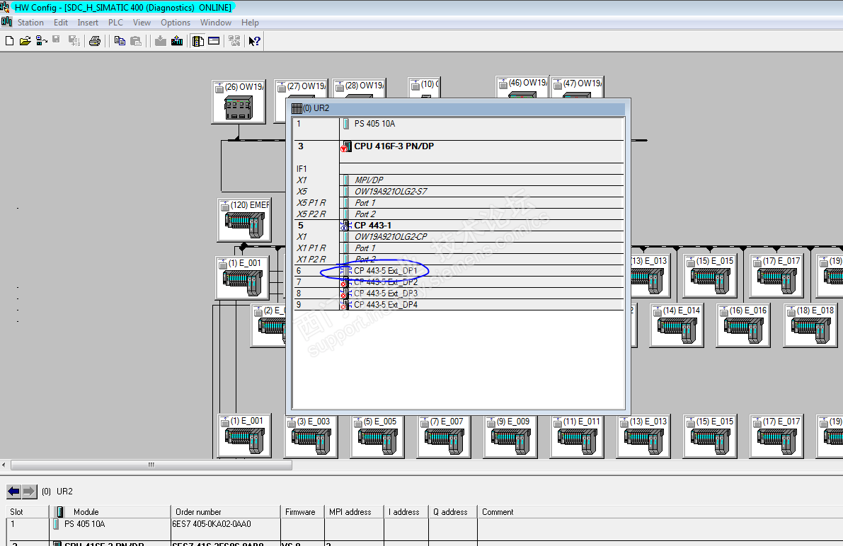

现场cpu416F 插着CP 443-5 通信卡,下面挂着100多个站,cp卡停机了,重启也不行,断电后正常,在线硬件组态无法访问诊断缓存区,可以访问cpu 的诊断缓存区。

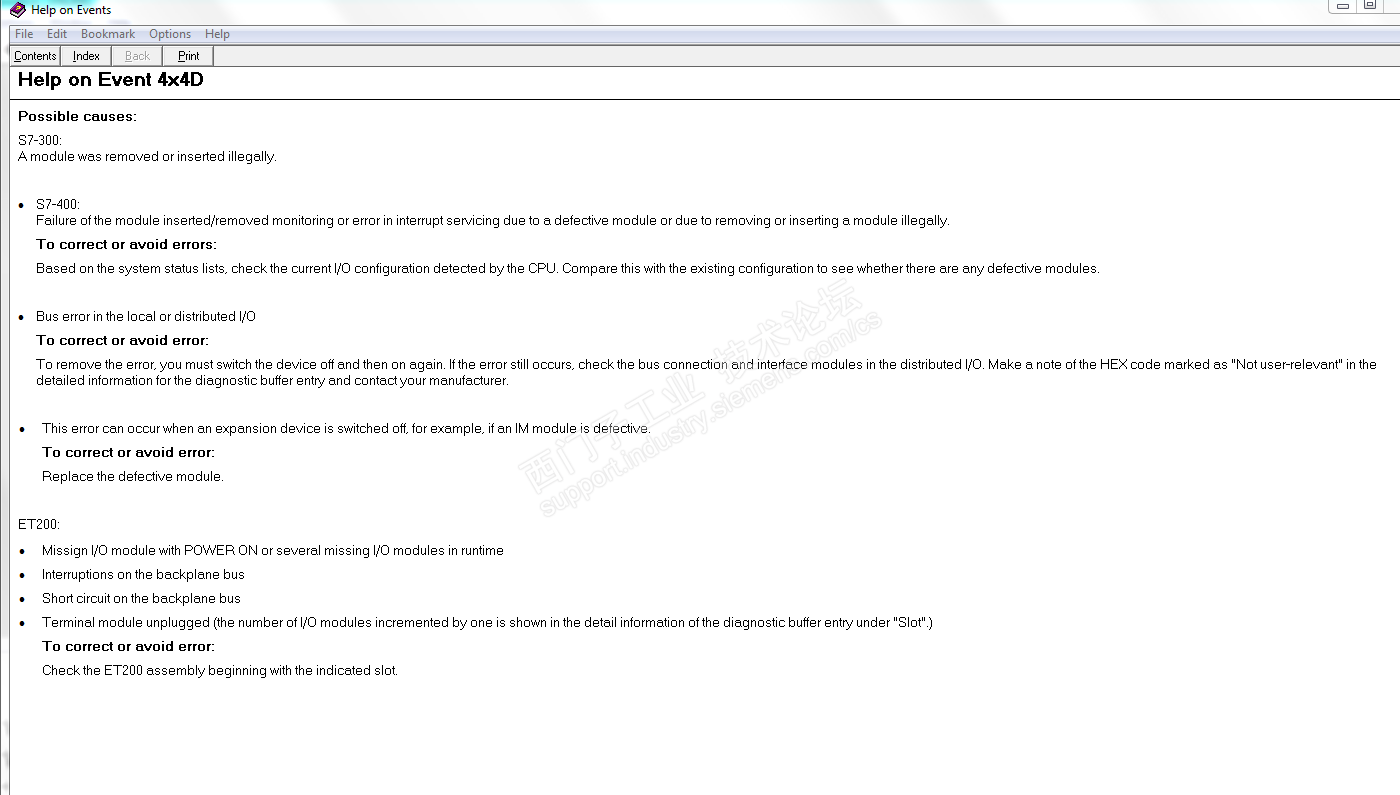

Event 2 of 120:  Event ID 16# 494D
STOP due to IO error
No relevance for user (Z1): 940b
No relevance for user (Z2): 0006 (Z3): 0078
Previous operating mode: RUN
Requested operating mode: STOP (internal)
External error, Incoming event
04:21:23.623 PM  02/24/2018
(Coding: 16# 494D  FF84  5050  940B  0006  0078)
