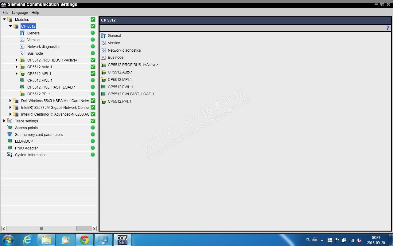

cp5512怎么用在win7 64位的系统上

下面的是搜索出来的,不是很明白他怎么操作的可以让cp5512兼容win7 64位的系统
Hi
This is my story about CP5512 and TIA Portal V13.1.
I don't know why or how but I managed to run a full service CP5512 windows 7 64-bit and TIA Portal V13.1. I have used different drivers downloaded from the network. And as a result I lost even Windows Defender (you could not turn it on). I enjoyed the full functionality CP5512 both sr4 Step7 v5.5 and TIA Portal V13.1. (Those who need to use STEP 7 while the TIA Portal V13.1 know how annoying is the constant reloading systems XP 32-bit and 64-bit Win7). When migrating to a larger hard disk, reinstall Win7 and the TIA Portal unfortunately CP5512 stopped working. It is in the system but you can not use it. The cure turned out to be copying from previous disc contents of the directory C:  Program Files  Common Files  Siemens  Automation.
Siemens CP5512 deliberately blocking service to force the abandonment of STEP 7. Unfortunately serving a large amount of applications S7-300 / 400 while exchanging panels on Basic 2 or new Comfort we are doomed to two systems (XP and Win7).
