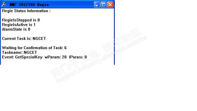

试了几种方法都不行。
如红色代码示意:
Function State_Changed(ByVal Action As String, ByVal newstate As Integer, ByVal oldstate As Integer) As Integer
    Select Case oldstate
       Case 0
            Select Case Action
                 Case "0"
                    'Write_Dialog ("selected 0 button")
                 Case "1"
                    'Write_Dialog ("selected 1 button")
                 Case "2"
                    'Write_Dialog ("selected 2 button")
                 Case "13"
                    'Write_Dialog ("SAVE")
                 Case "14"
                    'Write_Dialog ("Abort")
                 Case "15"  'Exit APP
                    'QueryForShutdown CONTEXT_REGIE_EXIT
                    'Unload OEMFRM0
                    End
            End Select
       Case 1
            Select Case Action
                 Case "13"
                    'Write_Dialog ("SAVE1")
                 Case "14"
                    'Write_Dialog ("Abort1")
                 Case "15"
                    'Write_Dialog ("Back")
            End Select
    End Select
End Function
直接写 End 如上面红色代码示意
代码执行时
按下Exit按钮APP退出但是HMI死机了,regie 状态如下图示:
请各位老师指导一下,谢谢!
