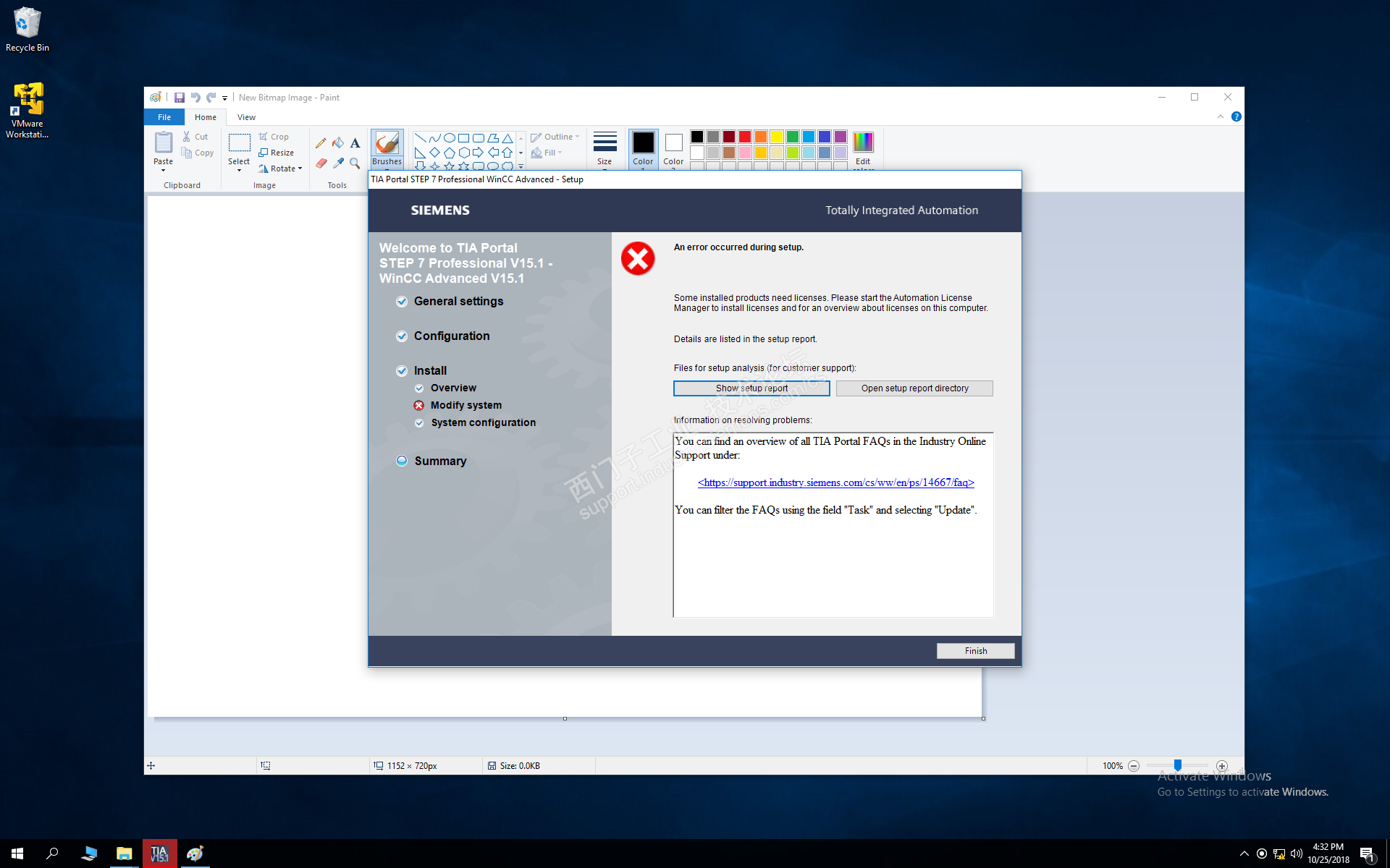

2.WIN10安装V15.1提示“已安装的产品需要许可证”,安装终止。
      解决思路:
      点击报错界面里的“show setup report”,查看安装日志。
09:30:18 |ERROR    AdsWorkerClassicProduct::OnWorkerCompleted():  - ClassicProduct setup result: -1: SQL Server installation not possible, extraction of SQL media failed
09:30:18 | FAIL!                     SetupUnit                  (INSTSQL2014EXP)            Failed    ClassicProductAddLocal
09:30:18 | FAIL!                     Checkpoint                 (E)                         Complete
09:30:18 |ERROR    ExecutionEngine::StartNextStepAsync():  - Execution has been cancelled. Probably because of some process(es) running on the machine
09:30:18 | SKIP!                     SetupUnit                  (CONFSQL2014EXP)            Skip      ClassicProductAddLocal
安装终止于INSTSQL2014EXP。

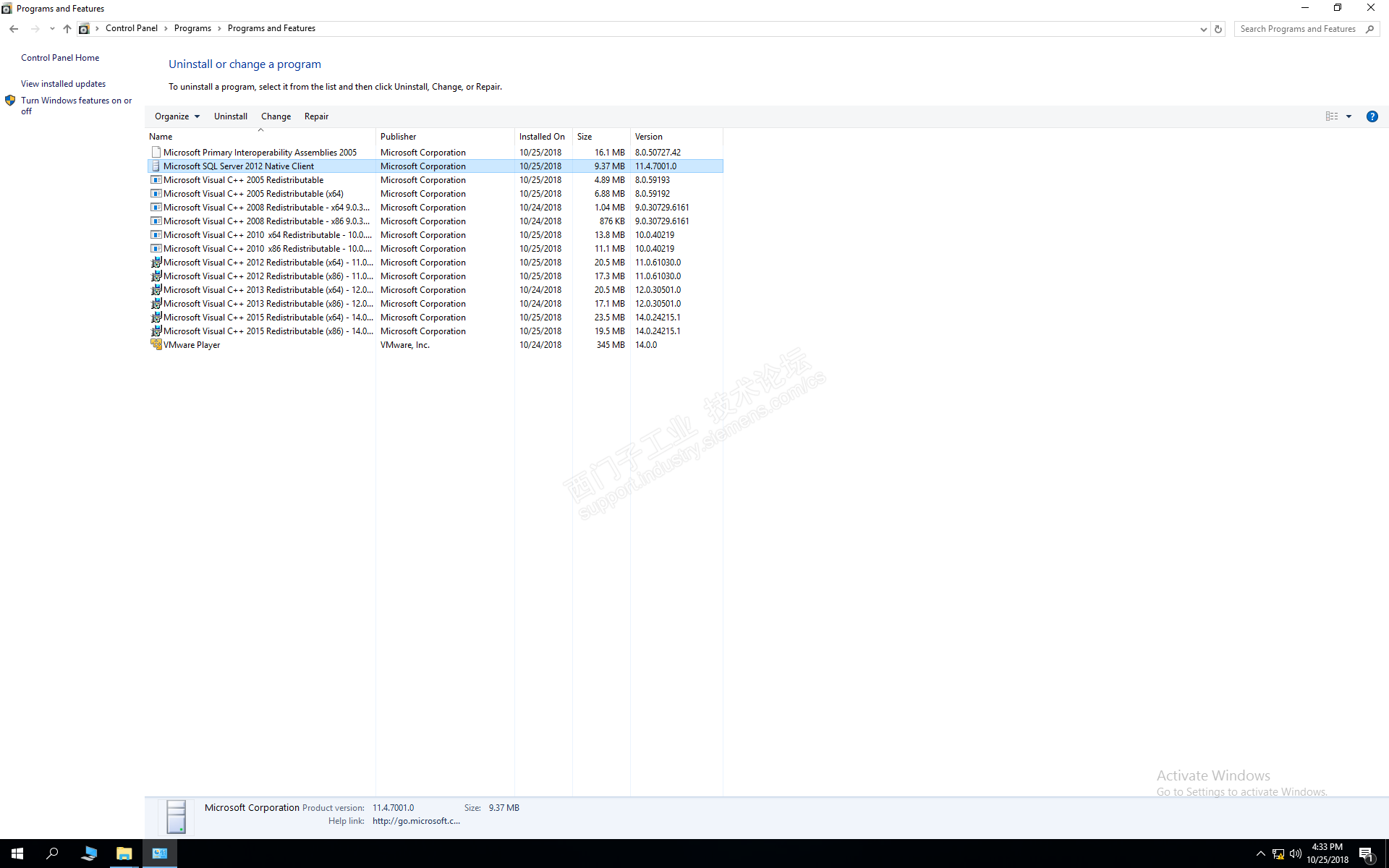

查看SQL安装日志,提示与 SQL Server 2012 Native Client 有关。
在控制面板卸载 SQL Server 2012 Native Client后,重新安装V15.1成功。
