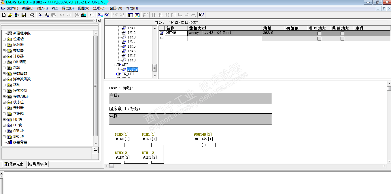

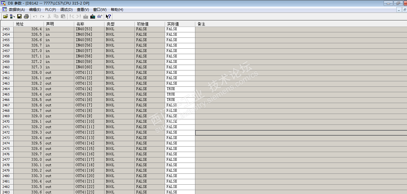

问题1:FB的背景数据块和FB中的OUT接口为什么不一样, 在FB块中OUT里面是OUT49,但是在其背景数据块DB142中是OUT41,背景数据块不都是自动根据FB生成的吗,怎么会不同?
问题2:FB块中是IN接口是从IN1到IN48,而且程序中在用,而DB142中只有IN1-IN40,背景数据块的参数无法修改,尝试另外新建一个背景数据块好像也新建不了
请教大家给支支招

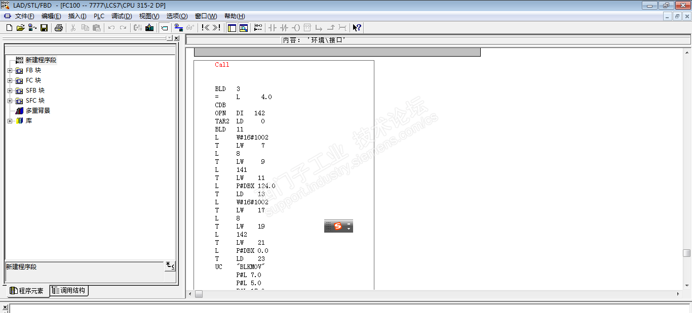

感谢zhangli0,程序调用的地方call和endcall显示红色,无法更新
 Call
      BLD   3
      =     L      4.0
      CDB
      OPN   DI   142
      TAR2  LD     0
      BLD   11
      L     W#16#1002
      T     LW     7
      L     8
      T     LW     9
      L     141
      T     LW    11
      L     P#DBX 124.0
      T     LD    13
      L     W#16#1002
      T     LW    17
      L     8
      T     LW    19
      L     142
      T     LW    21
      L     P#DBX 0.0
      T     LD    23
      UC    "BLKMOV"
            P#L 7.0
            P#L 5.0
            P#L 17.0
      BLD   11
      L     W#16#1002
      T     LW     7
      L     8
      T     LW     9
      L     142
      T     LW    11
      L     P#DBX 8.0
      T     LD    13
      L     W#16#1002
      T     LW    17
      L     8
      T     LW    19
      L     142
      T     LW    21
      L     P#DBX 8.0
      T     LD    23
      UC    "BLKMOV"
            P#L 7.0
            P#L 5.0
            P#L 17.0
      UC    "BLKMOV"
            P#L 7.0
            P#L 5.0
            P#L 17.0
      BLD   11
      L     W#16#1002
      T     LW     7
      L     8
      T     LW     9
      L     142
      T     LW    11
      L     P#DBX 104.0
      T     LD    13
      L     W#16#1002
      T     LW    17
      L     8
      T     LW    19
      L     142
      T     LW    21
      L     P#DBX 104.0
      T     LD    23
      UC    "BLKMOV"
            P#L 7.0
            P#L 5.0
            P#L 17.0
      BLD   11
      L     W#16#1002
      T     LW     7
      L     8
      T     LW     9
      L     142
      T     LW    11
      L     P#DBX 112.0
      T     LD    13
      L     W#16#1002
      T     LW    17
      L     8
      T     LW    19
      L     142
      T     LW    21
      L     P#DBX 112.0
      T     LD    23
      BLD   4
      End Call
