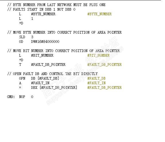

      OPN   DB [#FAULT_DB]
      A     #FAULT_IN
      =     DBX [#FAULT_DB_POINTER]
各位大侠,我想把这段用STL编的程序转换成SCL语言,可是到最后" OPN   DB [#FAULT_DB],A     #FAULT_IN,  =     DBX [#FAULT_DB_POINTER]"这段怎么也做不出,由于刚开始学习SCL,很多地方还都不太清楚,烦请各位大侠指点一下,万分感谢!
