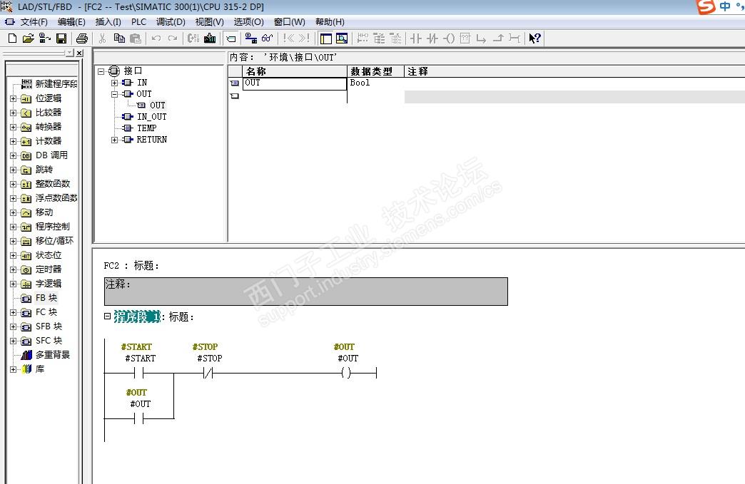

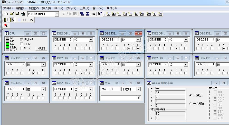

关于STL 如何把计算结果输出出来到指定的变量?请大家多多指教
nyzjs
    24
注册时间:2010-09-20
560
2019-06-12 22:00:31
OPN   DB     2                    //打开数据块
      L     MW    10
      L     P#1.0
      +I                                //自加1
      T     MW    10
      LAR1
      A     DBX [AR1,P#0.0]
      =     M      0.0
      A     DBX [AR1,P#0.1]
      =     M      0.1
      CALL  FC     2                    //调用功能块
       START:=M0.0
       STOP :=M0.1
       OUT  :=M0.2                      //如何把计算结果输出出来到指定的变量
      A     M      0.2
      =     DBX [AR1,P#0.2]
      L     MW    10
      L     40
      >=I
      JCN   A1
      L     P#0.0
      T     MW    10
A1:   NOP   0
