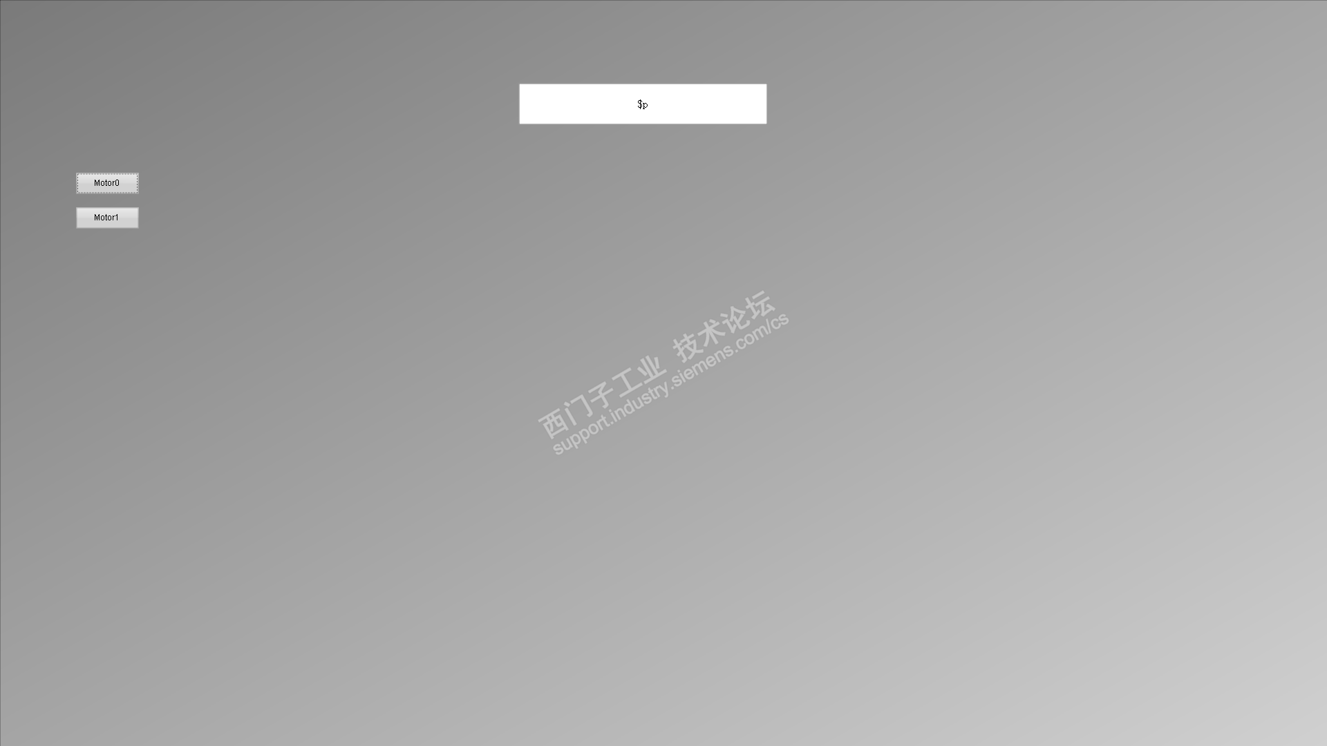

以下是引用西门小伙在2019-07-29 17:13:47的发言 >6楼
帮我看看,谢谢
sRet=SysMalloc(10);
if (((GetTagWord("Motor0.PUTCommand")&0x1)==0 )&& ((GetTagWord("Motor0.PUTCommand")&0x2)==0))
    strcpy(sRet,"停止");
if (((GetTagWord("Motor0.PUTCommand")&0x1)==1) && ((GetTagWord("Motor0.PUTCommand")&0x2)==0))
    strcpy(sRet,"运行");
if (((GetTagWord("Motor0.PUTCommand")&0x1)==0) && ((GetTagWord("Motor0.PUTCommand")&0x2)==1))
    strcpy(sRet,"故障");
  return (sRet);
我给Motor0.PUTCommand赋值2时,故障条件满足,显示不对
你这样写的目的是干什么?
sRet=SysMalloc(10);
if (GetTagWord("Motor0.PUTCommand")==0 )
    strcpy(sRet,"停止");
if (GetTagWord("Motor0.PUTCommand")==1)
    strcpy(sRet,"运行");
if (GetTagWord("Motor0.PUTCommand")==2)
    strcpy(sRet,"故障");
  return (sRet);
