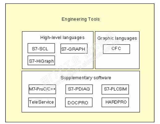

回复:创建语言是C FOR S7,这是什么编程语言?
我心依旧555
    769
    9
    35
注册时间:2009-09-12
发布于 2020-08-13 09:15:07
看手册,就是C语言,据说还有个M7系列的PLC不在国内销售个
Supplementary Software
? Borland C++ (M7 only) contains the Borland development environment.
? With DOCPRO you can organize all configuration data created under STEP 7 into wiring
manuals. These wiring manuals make it easy to manage the configuration data and allow the
information to be prepared for printing according to specific standards.
? HARDPRO is the hardware configuration system for S7-300 with user support for large-scale
configuration of complex automation tasks.
? M7 ProC/C++ (M7 only) allows integration of the Borland development environment for the
programming languages C and C++ into the STEP 7 development environment.
? You can use S7 PLCSIM (S7 only) to simulate S7 programmable controllers connected to the
programming device or PC for purposes of testing.
? S7 PDIAG (S7 only) allows standardized configuration of process diagnostics for SIMATIC
S7-300/S7-400. Process diagnostics let you detect faults and faulty states of PLC I/O (for
example, limit switch not reached).
? TeleService is a solution providing functions for online programming and servicing of remote
S7 and M7 PLCs via the telecommunications network with your PG/PC.
