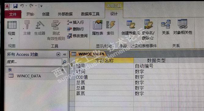

将WINCC数据写入ACCESS中
操作系统WIN10企业版 LTSC 2019  ,版本1809
WINCC:  WINCC V7.4 SP1+UPD15 :这个系统必须安装WINCC补丁 UPD15,要不然和PLC通讯是断开的
 OFFICE:  OFFICE2010  32位
在系统DSN建立数据源和数据库的链接
数据库创建:
数据类型设置位:文本。
SampleDSN为配置ODBC中系统DSN---数据源
WINCC_DATA位ACCESS数据库中表得命名
在WINCC全局脚本下新建VBS动作,脚本处罚周期   2秒,脚本程序
Dim objConnection
Dim strConnectionString
Dim data1,data2,data3,data4,data5
Dim strSQL
Dim objCommand
data5=Now
strConnectionString = "Provider=MSDASQL;DSN=SampleDSN;UID=;PWD=;"
data1 = HMIRuntime.Tags("出水COD.PV").Read
data2 = HMIRuntime.Tags("出水总氮.PV").Read
data3 = HMIRuntime.Tags("出水总磷.PV").Read
data4 = HMIRuntime.Tags("出水氨氮.PV").Read
strSQL = "INSERT INTO WINCC_DATA (COD值,总氮,总磷,氨氮,时间) VALUES ('" & data1 & "','" & data2 & "','" & data3 & "','" & data4 & "','" & data5 & "');"
Set objConnection = CreateObject("ADODB.Connection")
objConnection.ConnectionString = strConnectionString
objConnection.CursorLocation = 3
objConnection.Open
Set objCommand = CreateObject("ADODB.Command")
With objCommand
    .ActiveConnection = objConnection
    .CommandText = strSQL
End With
objCommand.Execute
Set objCommand = Nothing
objConnection.Close
Set objConnection = Nothing
