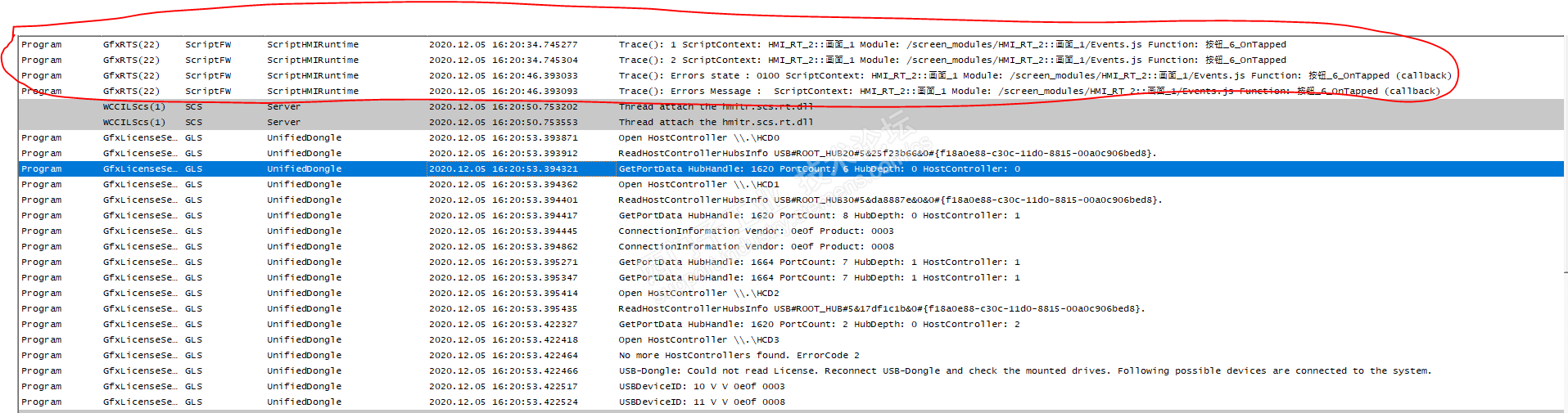

用unified 跟SQL Server连接,语句是unified自带的,改了一下连接的语句,但是一直连不通,用traceviewer 抓到的信息,没有什么意义:下面是编写的语句,放在一个按钮触发:
export function 按钮_6_OnTapped(item, x, y, modifiers, trigger) {
(async function() {
 try{
  HMIRuntime.Trace("1");
  //let connectionstring = "data source=SK-20200905CGAE\SQLEXPRESS;initial catalog=test;integrated security=sspi;";
  //let connectionstring = "Driver=ODBC Driver 11 for SQL Server; Server=localhost; Database=test;trusted_connection=yes;";
//let connectionstring1 = "Driver={sql server};server=SK-20200905CGAE\SQLEXPRESS;database=test;uid=sa;pwd=123456;" ;
 let connectionstring = "Driver={SQL Server}; Server=SK-20200905CGAE\SQLEXPRESS; Database=test;uid=sa;pwd=123456;";
  HMIRuntime.Trace("2");
  let conn = await HMIRuntime.Database.CreateConnection(connectionstring);
  HMIRuntime.Trace("333");
  let query = "Select * from test;";
  let results = await conn.Execute(query);
  HMIRuntime.Trace("4");
   if(results !== undefined && results !== null)
    let statements = results.Results;
    for(let statement in statements)
      let rows = statements[statement].Rows;
      for (let i in rows)
        let row = rows[i];
        for(let key in row)
           HMIRuntime.Trace(key+":"+row[key]);
  conn.Close();
catch(e)
  let res = e.Results;
  for(let statement in res)
    let errors = res[statement].Errors;
    for (let i in errors)
        let detailed = errors[i];
        HMIRuntime.Trace("Errors state : "+detailed.State);
        HMIRuntime.Trace("Errors Message : "+detailed.Message);
下面是抓到的信息
数据库的服务器名称,数据库,用户名,密码用sql server management studio测试过是没问题的
哪位大神做过的,请指教一下
