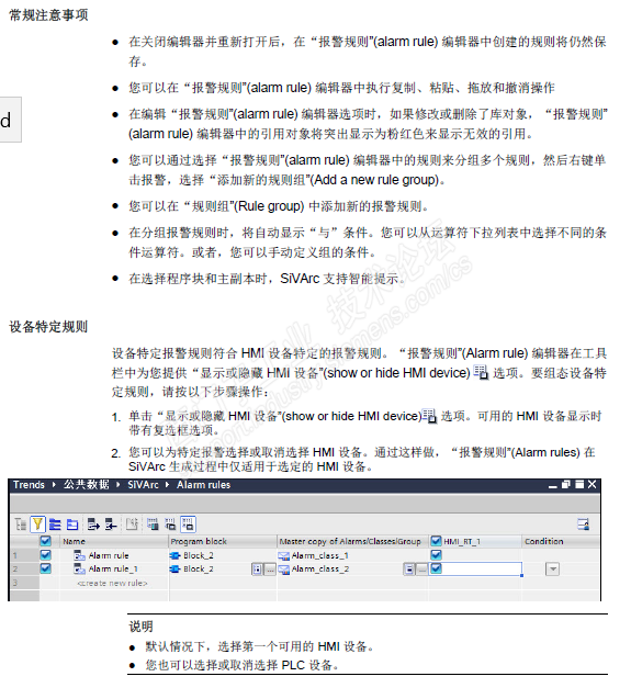

V15 – Simple Sample: SiVArc – creating Alarms
https://support.industry.siemens.com/tf/cn/zh/posts/v15-simple-sample-sivarc-creating-alarms/182535/?page=0&pageSize=10
