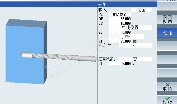

G54 G17 G90
G00 Z100
X0 Y0
F300 S1200 M3
CYCLE82(50,0,10,-25,,0,10,1,12)
G00 X100 Y100
F160
CYCLE82(50,0,10,-5,,0,10,1,12)
M5M30
