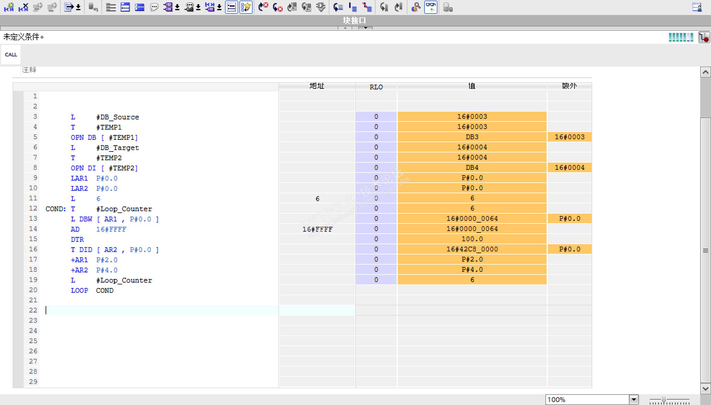

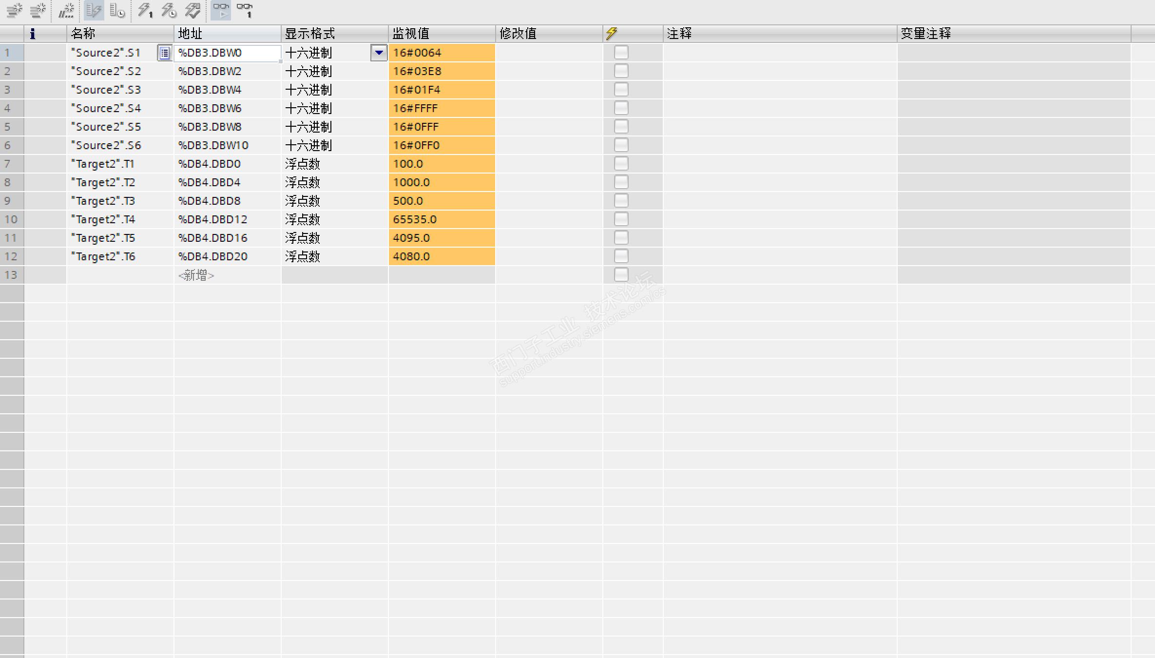

把一个DB块连续地址的WORD类型数据转成REAL类型存于另一个DB块,程序已经仿真验证。
1、STL 程序
FC块程序
VAR_INPUT
      DB_Source : Word;
      DB_Target : Word;
   END_VAR
   VAR_IN_OUT
      Loop_Counter : Int;
   END_VAR
   VAR_TEMP
      TEMP1 : Word;
      TEMP2 : Word;
   END_VAR
BEGIN
NETWORK
TITLE =
      L #DB_Source;
      T #TEMP1;
      OPN DB[ #TEMP1];
      L #DB_Target;
      T #TEMP2;
      OPN DI[ #TEMP2];
      LAR1 P#0.0;
      LAR2 P#0.0;
      L 6;
COND:      T #Loop_Counter;
      L DBW[ AR1, P#0.0];
      AD 16#FFFF;
      DTR;
      T DID[ AR2, P#0.0];
      +AR1 P#2.0;
      +AR2 P#4.0;
      L #Loop_Counter;
      LOOP COND;
END_FUNCTION
OB1程序
BEGIN
NETWORK
TITLE =
      CALL "FC_STL_WORD_TO_REAL"
      (  DB_Source                   := 16#3 ,
         DB_Target                   := 16#4 ,
         Loop_Counter                := "Value"
NETWORK
TITLE =
END_ORGANIZATION_BLOCK
仿真结果如下:
