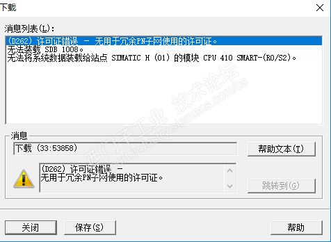

无法下载至PLC,说无用于冗余PN子网使用的许可证
sikele
    8
注册时间:2020-09-05
1768
2021-05-16 14:24:52
(D262) 许可证错误 –
无用于冗余PN子网使用的许可证。
点详细

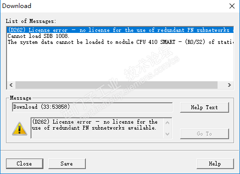

英文版
(D262) License error – no license for the
use of redundant PN subnetworks available.
click details

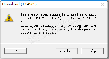

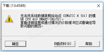

The system data cannot be loaded to module
CPU 410 SMART - (R0/S2) of station SIMATIC
H (01).

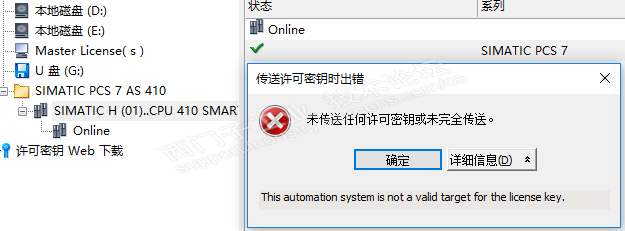

尝试了一下按pdf使用升级Key expansion pack,但是无法传送到Online里面去
Drag the license keys for the CPU 410 expansion packs and drop them on to the automation system for which you want to perform the upgrade.
This automation system is not a valid target for the license key.
