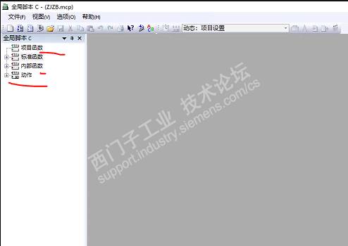

以下是引用zhangli0在2021-05-22 09:13:55的发言 >1楼
#include "apdefap.h"
 long _main(char* lpszPictureName, char* lpszObjectName, char* lpszPropertyName)
// WINCC:TAGNAME_SECTION_START
// syntax: #define TagNameInAction "DMTagName"
// next TagID : 2
#define TAG_1 "test_pv"
#define TAG_2 "alarm_h"
#define TAG_3 "alarm_hh"
// WINCC:TAGNAME_SECTION_END
// WINCC:PICNAME_SECTION_START
// syntax: #define PicNameInAction "PictureName"
// next PicID : 1
// WINCC:PICNAME_SECTION_END
if (GetTagFloat (TAG_1)>=GetTagFloat (TAG_3))//高高限
  return 84;//dark red
else if (GetTagFloat (TAG_1)>=GetTagFloat (TAG_2))//高限
  return 255;//red
else//正常值
 return 65280;//green
这个用哪个,项目函数还是动作?
