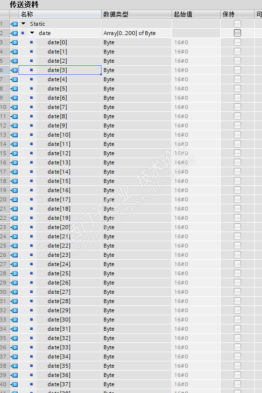

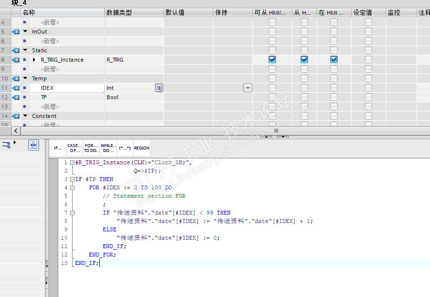

#R_TRIG_Instance(CLK:="Clock_5Hz",
                 Q=>#TP);
IF #TP THEN
    FOR #IDEX := 2 TO 100 DO
        // Statement section FOR
        IF "传送资料"."date"[#IDEX] < 99 THEN
            "传送资料"."date"[#IDEX] := "传送资料"."date"[#IDEX] + 1;
        ELSE
            "传送资料"."date"[#IDEX] := 0;
        END_IF;
    END_FOR;
END_IF;
