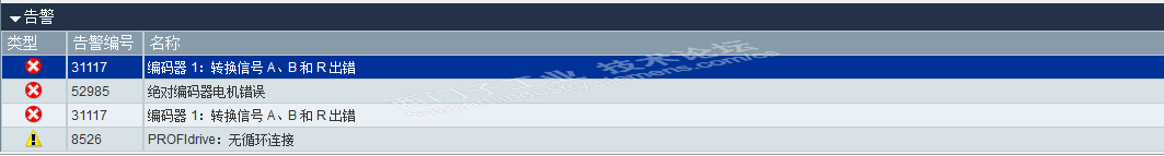

驱动器订货号6SL3210-5FB10-2UF0, 电机订货号1FL6032-2AF21-1LB1难道是驱动器与电机不匹配?
