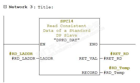

西门子官方教程,有兴趣的朋友可以看一下,Network 1和3 是一组,批量读取。
Network 1
 L     P##RD_RECORD
      LAR1
      L     P##RD_Temp
      T     #AD_Temp
      L     W [AR1,P#0.0]
      T     LW [#AD_Temp]
      L     #AD_Temp
      L     P#2.0
      +D
      T     #AD_Temp
      L     D [AR1,P#2.0]
      T     LD [#AD_Temp]
      L     #AD_Temp
      L     P#4.0
      +D
      T     #AD_Temp
      L     D [AR1,P#6.0]
      T     LD [#AD_Temp]
