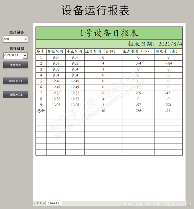

请教VBS在上面或者底部加个合计并一直置底应该怎么写?

Function Visible_Trigger(ByVal Item)
Dim kj1,kj2,kj3,kj4,kj5,kj6
Dim QR
Dim MSFlexGrid1
Dim LocalBeginTime, LocalEndTime,riqi
Dim oRs,oRs1, n,n1,i,z,s1,s11,oCom,oCom1,strcn,conn,pj
Dim zxy1
'查询当天全部数据,为标准
Set MSFlexGrid1 = ScreenItems("报表1") '对应表格控件名称
riqi = Now
LocalBeginTime = Year(riqi) & "-" & Month(riqi) & "-" & Day(riqi) & " " & "00:00:00"
LocalEndTime = Year(riqi) & "-" & Month(riqi) & "-" & Day(riqi) & " " & "23:59:59"
s1 = "SELECT TIME,weigh1,weigh2,weigh3,weigh4,weigh5 FROM WEIGH WHERE TIME BETWEEN '" &LocalBeginTime& "' and'" &LocalEndTime& "'ORDER BY TIME"
'S1 后面的内容要对应数据库中列的内容,后面的 DT 与前面的 DT 要名称一致,biao 要对应数据库列表名称 dbo.后面的名称
'这里要与数据库表名称一致,服务器一致
Strcn = "Provider=SQLOLEDB;Integrated Security=SSPI;Persist Security Info=false;Data Source=DESKTOP-PM6NF1O\WINCC;Initial Catalog = CHENGZHONG"
Set conn = CreateObject("ADODB.Connection")
conn.ConnectionString = strcn
conn.CursorLocation = 3
conn.Open
Set oRs = CreateObject("ADODB.Recordset")
Set oCom = CreateObject("ADODB.Command")
oCom.CommandType = 1
Set oCom.ActiveConnection = conn
oCom.CommandText = s1 '执行检索功能
Set oRs = oCom.Execute
n = oRs.RecordCount '获得检索到的总数
'HMIRuntime.Tags("I3").Write n
'定义在线表格属性
MSFlexGrid1.Clear
MSFlexGrid1.Rows = oRs.RecordCount +2
MSFlexGrid1.ColWidth(0) = 700 '第一列宽度设置
MSFlexGrid1.ColWidth(1) = 1200
MSFlexGrid1.ColWidth(2) = 1200
MSFlexGrid1.ColWidth(3) = 1200
MSFlexGrid1.ColWidth(4) = 1200
MSFlexGrid1.ColWidth(5) = 1200 '第 6 列宽度设置,如果列数多则继续添加
MSFlexGrid1.ColWidth(6) = 1200
MSFlexGrid1.RowHeight(0)= 600 '第一行高度设置
MSFlexGrid1.RowHeight(1)= 400
MSFlexGrid1.Row = 0
For z = 0 To 6 '根据上面的列数改变         '6
MSFlexGrid1.CellFontSize = 12 '字体大小
MSFlexGrid1.Col = z
MSFlexGrid1.Text = "糖分称重报表"
Next
MSFlexGrid1.MergeCells = 4 ' 相同内容合并单元格
MSFlexGrid1.MergeRow(0) = True '合并单元格
MSFlexGrid1.Row = 1
MSFlexGrid1.Col = z
MSFlexGrid1.CellBackColor =vbCyan '定义第二行颜色
Next
MSFlexGrid1.TextMatrix(1, 0) = "序号" '根据实际情况输入
MSFlexGrid1.TextMatrix(1, 1) = "日期"
MSFlexGrid1.TextMatrix(1, 2) = "1号锅(公斤)"
MSFlexGrid1.TextMatrix(1, 3) = "2号锅(公斤)"
MSFlexGrid1.TextMatrix(1, 4) = "3号锅(公斤)"
MSFlexGrid1.TextMatrix(1, 5) = "4号锅(公斤)"
MSFlexGrid1.TextMatrix(1, 6) = "5号锅(公斤)"
MSFlexGrid1.ColAlignment(0) = 4 '对齐方式,根据上面实际情况对应输入
MSFlexGrid1.ColAlignment(1) = 4
MSFlexGrid1.ColAlignment(2) = 4
MSFlexGrid1.ColAlignment(3) = 4 '对齐方式
MSFlexGrid1.ColAlignment(4) = 4
MSFlexGrid1.ColAlignment(5) = 4
MSFlexGrid1.ColAlignment(6) = 4
' 查询数据插入在线表格对应位置
If (n > 0) Then
oRs.MoveFirst '移动到数据库检索结果的第一行
i=0
Do While Not oRs.EOF '是否到记录末尾,循环填写表格
n = n + 1
MSFlexGrid1.TextMatrix(i+2,0) = i '根据上面实际情况对应输入
MSFlexGrid1.TextMatrix(i+2,1) = oRs.Fields(0).Value
MSFlexGrid1.TextMatrix(i+2,2) = oRs.Fields(1).Value
MSFlexGrid1.TextMatrix(i+2,3) = oRs.Fields(2).Value
MSFlexGrid1.TextMatrix(i+2,4) = oRs.Fields(3).Value
MSFlexGrid1.TextMatrix(i+2,5) = oRs.Fields(4).Value
MSFlexGrid1.TextMatrix(i+2,6) = oRs.Fields(5).Value
i=i+1
oRs.MoveNext
Loop
conn.Close
MSFlexGrid1.TopRow = MSFlexGrid1.Rows - 1 '移动到最后一行
Else
MsgBox "您所查询的时间段内没有数据......"
oRs.Requery
conn.Close
End If
End Function
想做成下面这样子:
底部有个总计,并且一直置底在最下面。
