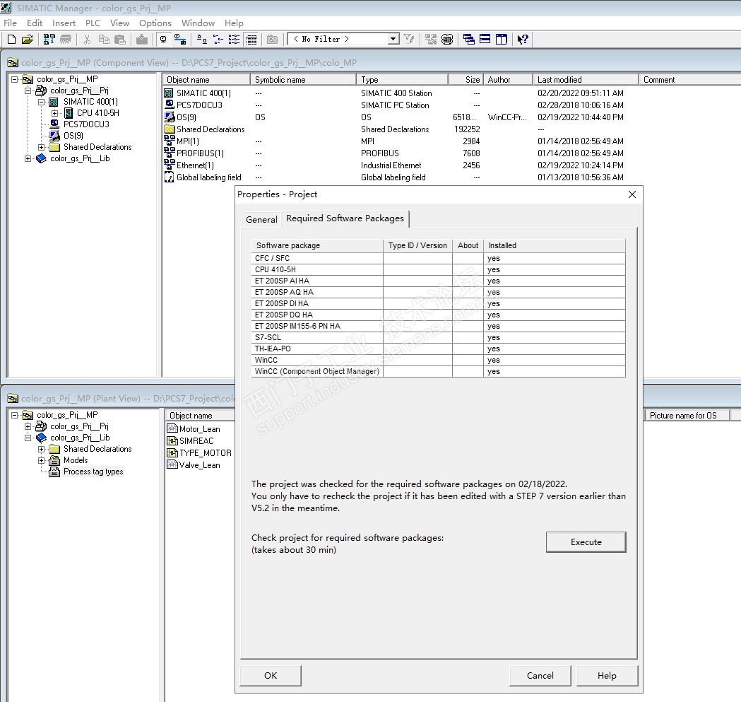

电脑系统Win10专业版,新安装的PCS7 V9.0,开始从入门学习PSC7,
从西门子网站上下载了范例程序 cloro_gs 研究,打开OS站的硬件配置,出现一堆报警:然后OS站硬件配置里面什么都没有
One or more objects or a type cannot be represented.
 Server 's7wbpcax.dll' for
_S7H_CLASS_PC_STATION_MGR_CT objects
could not be loaded.
Make sure the required
software packages are installed.
 Server 's7wbpchx.dll' for
_S7H_PC_ALLG_IE_CP_PNV2_V82_CT objects
 Server 'ccs7pcxx.dll' for
_S7H_CLASS_PC_WINCC_APPL_CT objects could
not be loaded.
Make sure the required software
看了项目属性,没有漏装的软件
这个一定会影响到OS编译,该如何解决,谢谢
另,OS的WinCC项目,就是哪个OS(9)可以正常打开
