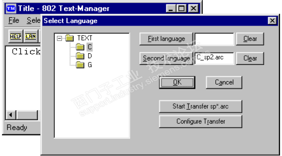

用文本管理器Text Manager安装语言:
对应版本toolbox:
802D sl TM PCU-Toolbox Software V01.02.00.01
(internal Versionsinfo 01.20.05.01)
   Order Number: 6FC5810-0YC12-0YA8
CD root directory  contains a file setup.exe.
After starting this file the program guides you through the installation
of the components.
