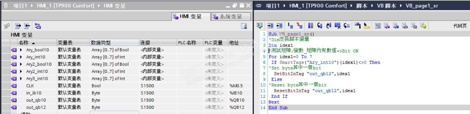

回复:TP900触碰萤幕脚本Byte取bit写法问题
n63185
    139
注册时间:2018-09-05
发布于 2022-03-25 16:22:26
4楼
已做出成果
這才是我要的答案@@
Please refer to the attachment. For the detailed description of the function, please refer to the manual:
https://support.industry.siemens.com/cs/cn/en/view/109794202/113504659851
https://support.industry.siemens.com/cs/cn/en/view/109794202/113163919115
