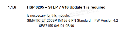

回复:6ES71556AU01-0BN0固件升级
nihaoa1122
    13
注册时间:2010-02-26
发布于 2022-05-30 18:23:27
6楼
去这个链接里下载最新的HSP包,安装上就有了,不过需要V16Upd1
HSP 0205 – STEP 7 V16 Update 1 is required
is necessary for this module:
SIMATIC ET 200SP IM155-6 PN Standard – FW-Version 4.2
– 6ES7155-6AU01-0BN0
https://support.industry.siemens.com/cs/cn/zh/view/72341852
