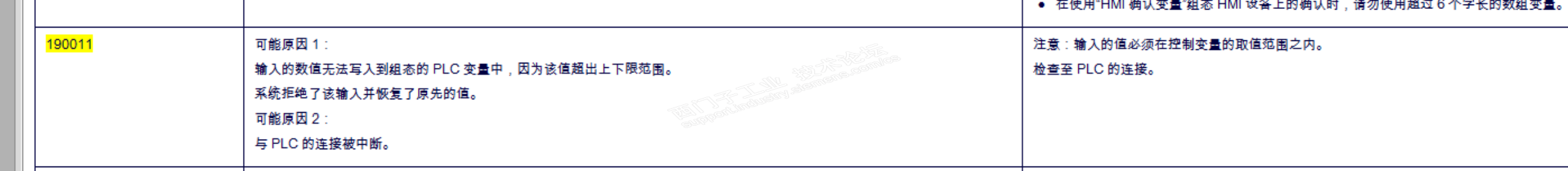

请问博途V17仿真HMI时报:Tag %1: value could not be written to the PLC??应该如何处理?
